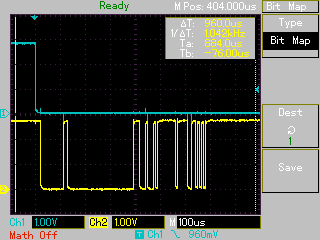

I am sensing interrupts on a pin using GPIOTE. I can see the interrupts coming on the oscilloscope. The firmware also detects the interrupts. However once I am inside the interrupt function, if I want to do a SPI transaction (in my case it is to retrieve data conversion of an ADC), then I never end the transaction. In fact the MISO line works fine (on the first conversion) as I can see on the oscilloscope. However after the transaction is done, the SPI peripheral should issue an interrupt to say the transfer is done but it does not.
I have been careful to set the code as non optimized, and I have given higher priority for the SPI than for the GPIOTE. By the way the SPI works well in normal mode when I configure the sensor registers (I verified with the oscilloscope)
Here is the oscilloscope picture with DRDY (interrupt) and MISO on first conversion (on the next conversions the MISO stays low):
Here is the SPI transaction code in the GPIOTE interrupt handler code (where rc is successful but xfer_done does not get true:
