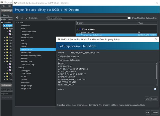

    Could you confirm that you have DEBUG defined in your Preprocessor Definitions of the Common build configuration, as shown in the included image?
    This will make a detailed error message be written to your logger whenever a non-NRF_SUCCESS error code is passed to an APP_ERROR_CHECK.
    Please do this, and let me know what this error message says.
    They are all defined like below:
    APP_TIMER_V2
    APP_TIMER_V2_RTC1_ENABLED
    BOARD_PCA10056
    CONFIG_GPIO_AS_PINRESET
    DEBUG
    DEBUG_NRF
    FLOAT_ABI_HARD
    INITIALIZE_USER_SECTIONS
    NO_VTOR_CONFIG
    NRF52840_XXAA
    NRF_SD_BLE_API_VERSION=7
    S140
    USBD_POWER_DETECTION

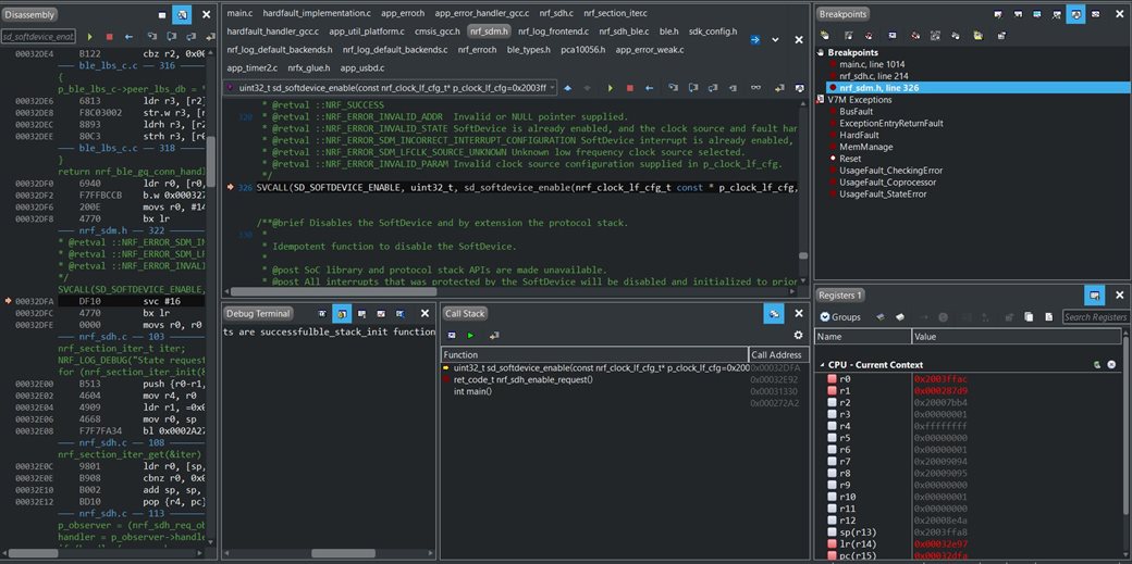

    I sorted the codes below how it goes into hardfault.
    First of all, I got the error while ble_stack_init now. On this init function, it goes into nrf_sdh_enable_request in line 5. The function can run to the line 56 "ret_code = sd_softdevice_enable(&clock_lf_cfg, app_error_fault_handler);". While the function from Softdevice "SVCALL(SD_SOFTDEVICE_ENABLE, uint32_t, sd_softdevice_enable(nrf_clock_lf_cfg_t const * p_clock_lf_cfg, nrf_fault_handler_t fault_handler));" in the file "nrf_sdm.h" runs, it leads up to hardfault like above.
    static void ble_stack_init(void)    //in main.c
        ret_code_t err_code;
        err_code = nrf_sdh_enable_request();  //runs to here
        uint32_t ram_start = 0;
        // Enable BLE stack.
    /* And go inside the function in the other c file */
    ret_code_t nrf_sdh_enable_request(void)
        ret_code_t ret_code;
        if (m_nrf_sdh_enabled)
            return NRF_ERROR_INVALID_STATE;
        m_nrf_sdh_continue = true;
        // Notify observers about SoftDevice enable request.
        if (sdh_request_observer_notify(NRF_SDH_EVT_ENABLE_REQUEST) == NRF_ERROR_BUSY)
            // Enable process was stopped.
            return NRF_SUCCESS;
        // Notify observers about starting SoftDevice enable process.
        sdh_state_observer_notify(NRF_SDH_EVT_STATE_ENABLE_PREPARE);
        nrf_clock_lf_cfg_t const clock_lf_cfg =
            .source       = NRF_SDH_CLOCK_LF_SRC,
            .rc_ctiv      = NRF_SDH_CLOCK_LF_RC_CTIV,
            .rc_temp_ctiv = NRF_SDH_CLOCK_LF_RC_TEMP_CTIV,
            .accuracy     = NRF_SDH_CLOCK_LF_ACCURACY
        CRITICAL_REGION_ENTER();
    #ifdef ANT_LICENSE_KEY
        ret_code = sd_softdevice_enable(&clock_lf_cfg, app_error_fault_handler, ANT_LICENSE_KEY);
    #else
        ret_code = sd_softdevice_enable(&clock_lf_cfg, app_error_fault_handler);    //Here, in this function
        m_nrf_sdh_enabled = (ret_code == NRF_SUCCESS);
        CRITICAL_REGION_EXIT();
        if (ret_code != NRF_SUCCESS)
            return ret_code;
        m_nrf_sdh_continue  = false;
        m_nrf_sdh_suspended = false;
        // Enable event interrupt.
        // Interrupt priority has already been set by the stack.
        softdevices_evt_irq_enable();
        // Notify observers about a finished SoftDevice enable process.
        sdh_state_observer_notify(NRF_SDH_EVT_STATE_ENABLED);
        return NRF_SUCCESS;
    /* the section of the code leading up to the error in the header file nrf_sdm.h */

    The SoftDevice will require some allocated memory, so you should use the memory configuration of the multilink example. In the case that too little memory is allocated to the SoftDevice it will tell you what to change the parameters to in the logger's output upon runtime failure.
    Yes, there are return values which error or result I can get. But sorry, I can't see or don't know the return value.

  • Hello again, it0406
    A common cause of ble_stack_init failing or the SoftDevice triggering a hardfault is that the application tries to access resources that are blocked or restricted by the SoftDevice. I see that your calls to the clock driver attempts to control the clock peripheral directly, rather than through the SoftDevice's API. This is likely a cause of the issue. Please see the note in the nrf_drv_clock_lfclk_request API documentation.
    Could I ask why you are requesting the lfclk here?
    The app_timer library will use an RTC instance, and so you may use the app_timer library to create timers for your application needs without risking to access restricted or blocked peripehrals.
    Try to remove these calls for direct clock control and let me know if it resolves your issue.
    Karl
