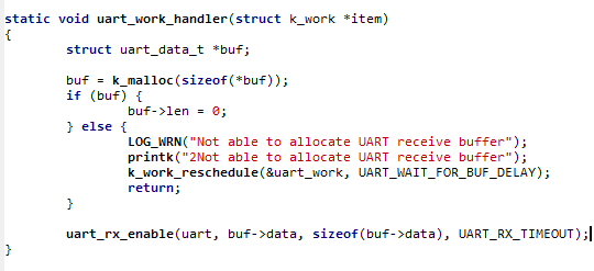

The issue come when i try to send 20 bytes every 0.2 seconds, when i start to send data is okey but with the time Not able to allocate UART receive buffer is triggered, and with this every function relationed with UART is broken, triggering Not able to allocate UART receive buffer/Not able to allocate UART send data buffer.
I think is something about buffers space. If somebody could explain me how to solve i was gratefull,

    it sounds like you may not be freeing your buffers properly. Could you doublecheck that?
    Is your code based on the sample at nrf/samples/bluetooth/central_uart? In that sample allocated 'buf's are passed to k_free() after they are used, to avoid memory leaks.

    There are many places along the code where a uart_data_t buffer is declared, later uses function k_malloc(buff), but there isn't a k_free later. For example here i got that error.

    If I put at the end of the function on first image a k_free i got this error:
    ASSERTION FAIL [chunk_used(h, c)] @ WEST_TOPDIR/zephyr/lib/os/heap.c:154
    unexpected heap state (double-free?) for memory at 0x2000949c
    So please, i need a recomendation/guidance to how, where and when i need to clean that buffers.

  • A buffer allocated for UART RX, like the one in uart_work_handler(), is freed after the data is sent over BLE.
    After the data is sent over BLE, the callback ble_data_sent() is called and this is where the buffer is passed to k_free().
    Have you made any changes to the application? Anything which allocates data or uses the FIFOs?
