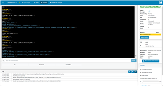

I have 2 9160DK's and for a few weeks now I've been trying to connect to the LTE network and then connect to the nRF Cloud (for the example of the at client and asset tracker) and so far without success.
I'm located in the north of Portugal, and reading the threads on DevZone about iBasis SIM a question came up: In the issue of network coverage NETWORK COVERAGE | iBASIS in Portgual, iBasis SIM says it's LTE-M national coverage, but when I look at Mobile IoT deployment Map GSMA | Mobile IoT Deployment Map | Internet of Things in Portugal shows NB-IoT nationwide coverage, so when loading .hex file to asset tracker DK should I load LTE-M or NB-IoT example?
With the previous question, I purchased an Altice M2M SIM to try to connect using the NB-IoT network (which I'm sure the NB-IoT coverage is supported), the connection attempts were also made with the iBasis SIM, and by the example of the AT Client it is always looking for the network and the connection never is established.
I don't know what is the issue for not getting the connection.
Any help I would appreciate a lot!!!
Best Regards, Caio.
Below I attach the logs and photos of the AT client using iBasis. I will soon send the log and photos using Altice's SIM.
