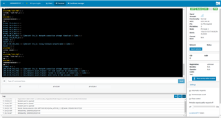

I have 2 9160DK's and for a few weeks now I've been trying to connect to the LTE network and then connect to the nRF Cloud (for the example of the at client and asset tracker) and so far without success.
I'm located in the north of Portugal, and reading the threads on DevZone about iBasis SIM a question came up: In the issue of network coverage NETWORK COVERAGE | iBASIS in Portgual, iBasis SIM says it's LTE-M national coverage, but when I look at Mobile IoT deployment Map GSMA | Mobile IoT Deployment Map | Internet of Things in Portugal shows NB-IoT nationwide coverage, so when loading .hex file to asset tracker DK should I load LTE-M or NB-IoT example?
With the previous question, I purchased an Altice M2M SIM to try to connect using the NB-IoT network (which I'm sure the NB-IoT coverage is supported), the connection attempts were also made with the iBasis SIM, and by the example of the AT Client it is always looking for the network and the connection never is established.
I don't know what is the issue for not getting the connection.
Any help I would appreciate a lot!!!
Best Regards, Caio.
Below I attach the logs and photos of the AT client using iBasis. I will soon send the log and photos using Altice's SIM.
2021-09-20T14_50_01.694Z-log.txtibasis SIM

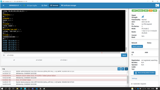

  • Hello Caio,
    From the logs you provided, the first thing that pops out is:
    2021-09-20T15:02:21.659Z DEBUG modem << +CEREG: 2,"BAC2","0012316F",9
    2021-09-20T15:02:24.672Z DEBUG modem << +CNEC_ESM: 111,0
    2021-09-20T15:02:24.679Z DEBUG modem << +CNEC_EMM: 15
    2021-09-20T15:02:24.687Z DEBUG modem << +CEREG: 2,"BAC2","0012316F",9,0,15
    Looking at the CEREG documentation we see that it is returning with a reject cause 15 - from 3GPP TS 24.301 Annex A this is described as:
    Cause #15 – No suitable cells in tracking area
    This EMM cause is sent to the UE if it requests service, or if the network initiates a detach request, in a tracking
    area where the UE, by subscription, is not allowed to operate, but when it should find another allowed tracking
    area or location area in the same PLMN or an equivalent PLMN.
    From 3GPP TS 24.008 - Annex H, subclause H.6.8 - Cause No. 111 "protocol error, unspecified", This cause is used to report a protocol error event only when no other cause in the protocol error class applies.
    With what SIM did you get this log? Do you get the same with the Altice M2M SIM?

  • Can you please let it run longer after the message: "Using fallback network mode"?
    Please let the board run for about 30 minutes.
    Øyvind
  • Hello , thank you again for your reply.
    I let run the asset tracker example with Altice's SIM for more than one hour, as you suggested. And still can't connect to any network, using fallback network mode.
    Looking at LTE Link Monitor I notice that once in a while the signal strength shows the 2 bars,  is this signal found is related to NB-IoT or could be any other cellular network?
    Here I put the output log:

    2021-09-21T13:09:47.921Z DEBUG modem << +CNEC: 24
    2021-09-21T13:09:47.922Z DEBUG modem << OK
    2021-09-21T13:09:47.925Z DEBUG modem >> AT+CGEREP?
    2021-09-21T13:09:47.937Z DEBUG modem << +CGEREP: 1,0
    2021-09-21T13:09:47.938Z DEBUG modem << OK
    2021-09-21T13:09:47.941Z DEBUG modem >> AT+CIND=1,1,1
    2021-09-21T13:09:47.952Z DEBUG modem << OK
    2021-09-21T13:09:47.955Z DEBUG modem >> AT+CEREG=5
    2021-09-21T13:09:47.959Z DEBUG modem << OK
    2021-09-21T13:09:47.961Z DEBUG modem >> AT+CEREG?
    2021-09-21T13:09:47.971Z DEBUG modem << +CEREG: 5,4
    2021-09-21T13:09:47.972Z DEBUG modem << OK
    2021-09-21T13:09:47.974Z DEBUG modem >> AT%CESQ=1
    2021-09-21T13:09:47.978Z DEBUG modem << OK
    2021-09-21T13:09:47.988Z DEBUG modem >> AT+CESQ
    2021-09-21T13:09:47.994Z DEBUG modem << +CESQ: 99,99,255,255,255,255
    2021-09-21T13:09:48.004Z DEBUG modem << OK
    2021-09-21T13:09:48.007Z DEBUG modem >> AT%XSIM=1
    2021-09-21T13:09:48.011Z DEBUG modem << OK
    2021-09-21T13:09:48.020Z DEBUG modem >> AT%XSIM?
    2021-09-21T13:09:48.024Z DEBUG modem << %XSIM: 1
    2021-09-21T13:09:48.026Z DEBUG modem <<
    2021-09-21T13:09:48.027Z DEBUG modem << OK
    2021-09-21T13:09:48.038Z DEBUG modem >> AT+CPIN?
    2021-09-21T13:09:48.043Z DEBUG modem << +CPIN: READY
    2021-09-21T13:09:48.053Z DEBUG modem << OK
    2021-09-21T13:09:48.056Z DEBUG modem >> AT+CPINR="SIM PIN"
    2021-09-21T13:09:48.070Z DEBUG modem << +CPINR: "SIM PIN",3
    2021-09-21T13:09:48.071Z DEBUG modem << OK
    2021-09-21T13:09:48.074Z DEBUG modem >> AT+CIMI
    2021-09-21T13:09:48.087Z DEBUG modem << 208090025028169
    2021-09-21T13:09:48.088Z DEBUG modem << OK
    2021-09-21T13:09:48.089Z INFO IMSIdentity: 208090025028169
    2021-09-21T13:17:36.870Z DEBUG modem << [00:28:00.477,355] [0m<inf> asset_tracker: Connecting to LTE network.[0m
    2021-09-21T13:17:36.891Z DEBUG modem << [00:28:00.484,008] [0m<inf> asset_tracker: This may take several minutes.[0m
    2021-09-21T13:17:36.892Z DEBUG modem << [00:28:00.491,088] [1;31m<err> asset_tracker: LTE link could not be established.[0m
    2021-09-21T13:17:36.893Z DEBUG modem << [00:28:00.498,779] [1;33m<wrn> asset_tracker: Failed to establish LTE connection.[0m
    2021-09-21T13:17:36.898Z DEBUG modem << [00:28:00.506,561] [1;33m<wrn> asset_tracker: Will retry in 480 seconds.[0m
    2021-09-21T13:20:43.485Z DEBUG modem >> +CPIN?
    2021-09-21T13:20:43.498Z DEBUG modem << +CME ERROR: 0
    2021-09-21T13:20:43.500Z ERROR Error: +CPIN?
     failed: phone failure
    2021-09-21T13:20:45.829Z DEBUG modem >> +CPIN:
    2021-09-21T13:20:45.847Z DEBUG modem << +CME ERROR: 0
    2021-09-21T13:20:45.849Z ERROR Error: +CPIN:
    2021-09-21T13:21:11.995Z DEBUG modem >> AT+CPIN?
    2021-09-21T13:21:12.007Z DEBUG modem << +CPIN: READY
    2021-09-21T13:21:12.011Z DEBUG modem << OK
    2021-09-21T13:21:12.012Z DEBUG modem >> AT+CPINR="SIM PIN"
    2021-09-21T13:21:12.026Z DEBUG modem << +CPINR: "SIM PIN",3
    2021-09-21T13:21:12.027Z DEBUG modem << OK
    2021-09-21T13:25:36.876Z DEBUG modem << [00:36:00.513,580] [0m<inf> asset_tracker: Connecting to LTE network.[0m
    2021-09-21T13:25:36.888Z DEBUG modem << [00:36:00.520,263] [0m<inf> asset_tracker: This may take several minutes.[0m
    2021-09-21T13:25:36.890Z DEBUG modem << [00:36:00.527,343] [1;31m<err> asset_tracker: LTE link could not be established.[0m
    2021-09-21T13:25:36.910Z DEBUG modem << [00:36:00.535,003] [1;33m<wrn> asset_tracker: Failed to establish LTE connection.[0m
    2021-09-21T13:25:36.911Z DEBUG modem << [00:36:00.542,785] [1;33m<wrn> asset_tracker: Will retry in 480 seconds.[0m
    2021-09-21T13:33:36.882Z DEBUG modem << [00:44:00.549,926] [0m<inf> asset_tracker: Connecting to LTE network.[0m
    2021-09-21T13:33:36.898Z DEBUG modem << [00:44:00.556,610] [0m<inf> asset_tracker: This may take several minutes.[0m
    2021-09-21T13:33:36.899Z DEBUG modem << [00:44:00.563,659] [1;31m<err> asset_tracker: LTE link could not be established.[0m
    2021-09-21T13:33:36.904Z DEBUG modem << [00:44:00.571,350] [1;33m<wrn> asset_tracker: Failed to establish LTE connection.[0m
    2021-09-21T13:33:36.924Z DEBUG modem << [00:44:00.579,132] [1;33m<wrn> asset_tracker: Will retry in 480 seconds.[0m
    2021-09-21T13:41:36.888Z DEBUG modem << [00:52:00.586,181] [0m<inf> asset_tracker: Connecting to LTE network.[0m
    2021-09-21T13:41:36.921Z DEBUG modem << [00:52:00.592,834] [0m<inf> asset_tracker: This may take several minutes.[0m
    2021-09-21T13:41:36.925Z DEBUG modem << [00:52:00.599,914] [1;31m<err> asset_tracker: LTE link could not be established.[0m
    2021-09-21T13:41:36.926Z DEBUG modem << [00:52:00.607,604] [1;33m<wrn> asset_tracker: Failed to establish LTE connection.[0m
    2021-09-21T13:41:36.927Z DEBUG modem << [00:52:00.615,386] [1;33m<wrn> asset_tracker: Will retry in 480 seconds.[0m
    2021-09-21T13:49:36.483Z DEBUG modem << [01:00:00.212,829] [1;33m<wrn> date_time: getaddrinfo, error: -11[0m
    2021-09-21T13:49:36.513Z DEBUG modem << [01:00:00.219,360] [1;33m<wrn> date_time: getaddrinfo, error: -11[0m
    2021-09-21T13:49:36.514Z DEBUG modem << [01:00:00.226,257] [1;33m<wrn> date_time: getaddrinfo, error: -11[0m
    2021-09-21T13:49:36.516Z DEBUG modem << [01:00:00.232,879] [1;33m<wrn> date_time: getaddrinfo, error: -11[0m
    2021-09-21T13:49:36.517Z DEBUG modem << [01:00:00.239,410] [1;33m<wrn> date_time: getaddrinfo, error: -11[0m
    2021-09-21T13:49:36.535Z DEBUG modem << [01:00:00.245,880] [1;33m<wrn> date_time: Not getting time from any NTP server[0m
    2021-09-21T13:49:36.894Z DEBUG modem << [01:00:00.622,436] [0m<inf> asset_tracker: Connecting to LTE network.[0m
    2021-09-21T13:49:36.903Z DEBUG modem << [01:00:00.629,119] [0m<inf> asset_tracker: This may take several minutes.[0m
    2021-09-21T13:49:36.930Z DEBUG modem << [01:00:00.636,199] [1;31m<err> asset_tracker: LTE link could not be established.[0m
    2021-09-21T13:49:36.931Z DEBUG modem << [01:00:00.643,890] [1;33m<wrn> asset_tracker: Failed to establish LTE connection.[0m
    2021-09-21T13:49:36.933Z DEBUG modem << [01:00:00.651,641] [1;33m<wrn> asset_tracker: Will retry in 480 seconds.[0m
  • , thanks for providing this log. In the beginning of the log the device still receives reject cause 15 while trying to connect NB-IoT network. Can you verify with Altice that this SIM supports NB-IoT? Is the SIM activated? Are you able to test with e.g. Vodafone?
     Given that NB-IoT is the only protocol supported in Portugal it should be NB-IoT. And from the logs you can see that the application uses fallback to switch to LTE-M.
     From the CEREG command you can see it is trying to connect NB-IoT, and I would assume that this is correct. Not sure why shows LTE-M for Portugal. Did you activate the iBasis SIM?
