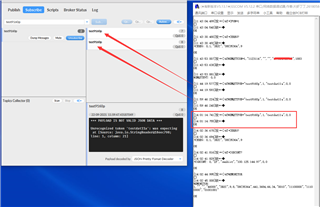

   I use NRF9160 serial_lte_modem to test  NBIOT/MQTT, current SDK is V1.6.0 ,and config mqtt keepalive =1200S.
  after 9160 connect net, control mqtt connect my mqtt server  and publish data. another mqtt client subscribe 9160 publish topic.
this log show, in 11:59:46 NRF9160 publish data to server,and another mqtt client recv this data .but in 14:01:14  nrf9160 publish data,another mqtt client don't recv data .

by AT log in 14:01:14,9160  should  be disconnected. Why the link will be disconnected?and this disconnect don't have event notification。If no notification ,I don't know when the 9160 is disconnected
     Are you sure the device was connected and subscribed to the correct topic?
    What QoS level did you use?
    I have not been able to reproduce this.
     Why should it be disconnected?
    Depending on the reason for the disconnect, you should get a MQTT event similar to this:
    #XMQTTEVT: 1,-113
    At the latest the next time the device publishes a message or sends a PING.

        the 9160 publish topic and another mqtt client subscribe topic  is same.
        MQTT config keepalive=1200S,and have two hours from 11:59 to 14:01. there should be 6 times keepalive and EVENT(#XMQTTEVT:9,0) return ,but none.  SO I thinks mqtt disconnect but  no  EVENT return
  • Did the other nRF9160 use the same client ID?
    Most MQTT brokers require that the client IDs are unique.
    I am also not able to reproduce your missing #XMQTTEVT events.
    And, if I increase the keepalive setting on the nRF9160 past the keepalive setting of the broker, I get an event saying that I am disconnected the next time the client tries to send a keepalive message.
