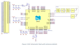

nRF9160 version 0.7 and 2.0 hardware configuration
Hello ;
We used NRF9160-SICA-B1A-R in our project. We have to choose the old version (NRF9160-SICA-R7) as NRF9160-SICA-B1A-R is out of stock.  the only difference, Some of the pins are NC in the old version and the pins connected  ground in the new version. Different configured Pins;  6,7,8,10,11,68,69.  Will this cause a problem?
