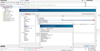

I tested the serial sending of the stm8l and it works perfectly. I use SES to read the code and I set up the project for nrf52805 following your guide.
I tested the project as it was born using nrf52805 as TX and an nrf52832 as RX doing various tests with the access of the LEDs and works perfectly, the problem arises having to serial receive the data from the micro that will then be sent to the receiver.
