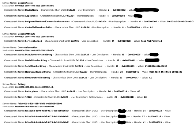

    The problem is that I never get BLE_DB_DISCOVERY_COMPLETE in the discover event. And, at
    BLE_DB_DISCOVERY_AVAILABLE I get this in the debugger:
    This are the peripheral services and characteristics, the peripheral is mature product of my company and works successfully with other centrals.
    What am I doing wrong?

  • Angel said:
    Thanks for your fast answer.
    No problem at all, I am happy to help! :)
    Angel said:
    As far I understand with the documentation and using the UART example, I should be able to do something like this:
    No, I think there might be a couple of possible things going wrong here.
    For example, you're registering the UUID's for service discovery and base UUID with the type UNKNOWN, since its 0. Do you get any runtime errors?
    From the services list I assume that you are going to accept notifications from some of these services, is this correct?
    I recommend that you create a separate source file for the services you will be accessing, akin to ble_lbs_c.c, ble_hrs_c.c, ble_bas_c.c, etc. You could take any one of the existing services source and header files to use as a template for this. This is best practice, rather than having it all be part of your main.c
    You might also want to make use of the GATT Queue library when working with multiple services and characteristics. The use of the GATT Queue library is also demonstrated in the BLE Central examples.
