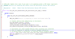

unable to perform OTA update on HUAWEI P20 lite
V	14:51:40.652	[DFU] DFU service started
V	14:51:40.652	[DFU] Opening file...
I	14:51:40.683	[DFU] Firmware file opened successfully
V	14:51:40.683	[DFU] Connecting to DFU target...
D	14:51:40.684	[DFU] gatt = device.connectGatt(autoConnect = false, TRANSPORT_LE, preferredPhy = LE_1M | LE_2M)
I	14:51:40.707	[DFU] Connected to F0:A4:5B:DC:7B:B3
D	14:51:40.708	[DFU] wait(1600)
V	14:51:42.309	[DFU] Discovering services...
D	14:51:42.309	[DFU] gatt.discoverServices()
I	14:51:42.316	[DFU] Services discovered
W	14:51:42.316	[DFU] Sending system components
D	14:51:42.342	[DFU] wait(1000)
W	14:51:43.335	[DFU] Application with buttonless update found
V	14:51:43.335	[DFU] Jumping to the DFU Bootloader...
V	14:51:43.335	[DFU] Enabling indications for 8ec90003-f315-4f60-9fb8-838830daea50
D	14:51:43.335	[DFU] gatt.setCharacteristicNotification(8ec90003-f315-4f60-9fb8-838830daea50, true)
D	14:51:43.335	[DFU] gatt.writeDescriptor(00002902-0000-1000-8000-00805f9b34fb, value=0x02-00)
D	14:51:43.623	[Broadcast] Action received: android.bluetooth.device.action.BOND_STATE_CHANGED, bond state changed to: BOND_BONDING (11)
D	14:51:43.651	[Broadcast] Action received: android.bluetooth.device.action.PAIRING_REQUEST, pairing variant: PAIRING_VARIANT_CONSENT (3)
I	14:51:43.926	Connection parameters updated (interval: 7.5ms, latency: 0, timeout: 5000ms)
D	14:51:57.073	[Callback] Connection state changed with status: 8 and new state: DISCONNECTED (0)
E	14:51:57.073	Error 8 (0x8): GATT CONN TIMEOUT
I	14:51:57.073	Disconnected
E	14:51:57.106	[DFU] Device has disconnected
D	14:51:57.106	[DFU] gatt.disconnect()
D	14:51:57.106	[Broadcast] Action received: android.bluetooth.device.action.BOND_STATE_CHANGED, bond state changed to: BOND_NONE (10)
I	14:51:57.107	Bonding failed
D	14:51:57.108	[DFU] gatt.close()
D	14:51:57.108	[Broadcast] Action received: android.bluetooth.device.action.ACL_DISCONNECTED

I	14:53:10.496	[DFU] Connected to F0:A4:5B:DC:7B:B3
D	14:53:10.497	[Broadcast] Action received: android.bluetooth.device.action.ACL_CONNECTED
D	14:53:10.498	[DFU] [Broadcast] Action received: android.bluetooth.device.action.ACL_CONNECTED
V	14:53:10.501	[DFU] Discovering services...
D	14:53:10.501	[DFU] gatt.discoverServices()
I	14:53:11.295	[DFU] Services discovered
W	14:53:11.295	[DFU] Sending system components
D	14:53:11.313	[DFU] wait(1000)
W	14:53:12.305	[DFU] Application with buttonless update found
V	14:53:12.305	[DFU] Jumping to the DFU Bootloader...
V	14:53:12.305	[DFU] Enabling indications for 8ec90003-f315-4f60-9fb8-838830daea50
D	14:53:12.305	[DFU] gatt.setCharacteristicNotification(8ec90003-f315-4f60-9fb8-838830daea50, true)
D	14:53:12.306	[DFU] gatt.writeDescriptor(00002902-0000-1000-8000-00805f9b34fb, value=0x02-00)
D	14:53:12.857	[Broadcast] Action received: android.bluetooth.device.action.BOND_STATE_CHANGED, bond state changed to: BOND_BONDING (11)
D	14:53:12.871	[Broadcast] Action received: android.bluetooth.device.action.PAIRING_REQUEST, pairing variant: PAIRING_VARIANT_CONSENT (3)
D	14:53:17.229	[Broadcast] Action received: android.bluetooth.device.action.BOND_STATE_CHANGED, bond state changed to: BOND_BONDED (12)
I	14:53:17.229	Device bonded
A	14:53:17.254	[DFU] Indications enabled
D	14:53:17.254	[DFU] wait(1000)
I	14:53:17.254	[DFU] Data written to descr.8ec90003-f315-4f60-9fb8-838830daea50, value (0x): 02-00
V	14:53:17.254	[DFU] Notifications enabled for 8ec90003-f315-4f60-9fb8-838830daea50
V	14:53:18.263	[DFU] Writing to characteristic 8ec90003-f315-4f60-9fb8-838830daea50
D	14:53:18.263	[DFU] gatt.writeCharacteristic(8ec90003-f315-4f60-9fb8-838830daea50)
A	14:53:19.252	[DFU] Enter bootloader sent (Op Code = 1)
I	14:53:19.252	[DFU] Notification received from 8ec90003-f315-4f60-9fb8-838830daea50, value (0x): 20-01-01
A	14:53:19.252	[DFU] Response received (Op Code = 1, Status = 1)
I	14:53:39.312	[DFU] Disconnected by the remote device
D	14:53:39.314	[DFU] gatt.disconnect()
D	14:53:39.318	[DFU] gatt.close()
V	14:53:39.320	[DFU] Scanning for the DFU Bootloader...
D	14:53:39.322	[Broadcast] Action received: android.bluetooth.device.action.ACL_DISCONNECTED

    What about this?:
    Vidar Berg said:
    In addition to shortening the supervision timeout, please check if your FW app attempts to terminate the connection before entering DFU mode.
    Does your application attempt to disconnect before entering DFU mode? If the link was terminated, the phone wouldn't have had to wait for the supervision timer to expire.
  • Thanks for confirming. I'm not sure why the phone is rejecting the CONN_SUP_TIMEOUT requested by your peripheral.
    What about this?:
