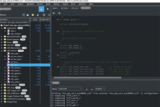

in my project i want to use watch dog timer in ble_app_uart_pca10040_s132   but  am getting error as shown in image1, even after including driver files and paths
actually in second image u can observe the condition  #ifndef SOFTDEVICE_PRESENT
so plz solve this issue
    You need remove the nrf_soc.c and nrf_nvic.c file from the project. These files are only meant to be used in projects which don't include the Softdevice.
  • Hello Vidar,
    Thanks for your reply
    Now WDT is running properly...!!
