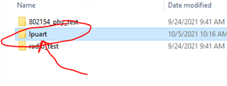

    I am make progress on send out characters through UART0 under mesh light sample. But I want to know more details on receiving messages from UART0 as sending stuff requires no any code merge.
    I could see lpuart here: \ncs\v1.6.1\nrf\samples\peripheral\lpuart
    But I could not find an option under SDK project window with lpuart and that is the reason I chose hci-_lpuart. Could you give me clues on this?
    Thanks a lot!
    Qi
  • Hey Qtang!
    You couldn't find it in the project drop-down menu? If not then you can allways find the folder yourself using the options button and then browsing through to nrf/samples/peripheral/lpuart.
    Was this what you were asking?
