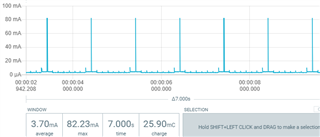

    Ok. The main thing is the TX power is at 80mA at peak. I have already set tx_power level to -40dBm. What I do have to do in order to bring down the power consumption?

  • Hi David,
    Are you using PPK1 or PPK2 to measure the current consumption? The peak you are getting in your measurement is the peak current of PPK1, which can mean you have a short circuit somewhere. We have seen this happen with the PPK1 before, giving current measurements around to 80 mA.
    Even so, the current consumption is most likely not actually 80 mA. According to nRF52840 radio transmitting/receiving current consumption, you should expect to get around 5 mA with -40 dBm output power. Even if something was configured incorrectly and output power was set to maximum you should not get more than 20 mA.
    Marte
  • Hi Marte,
    I am using PPKI. Maybe it reaches cut-off 80mA. After I managed nrf_rng_task_trigger(NRF_RNG_TASK_START) and HFXO, the Maximum current is down to 35mA. I know there are some rooms to go. I just need to go through all the steps and to minimize power. I am ok at this point.
