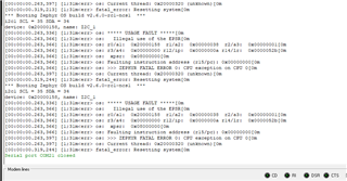

Hey all,
I've been learning/working on the 53 and have had some issues adding in the AMG8 example.
i've gotten the sensor to work flawlessly on an STM32 & nordic 52 but am unable to get it going on zephyr.
My log when running looks like this
*** Booting Zephyr OS build v2.6.0-rc1-ncs1  ***
i2c1 SCL = 35 SDA = 34
device: 0x20000158, name: I2C_1
[00:00:00.263,336] [1;31m<err> os: ***** USAGE FAULT *****[0m
[00:00:00.263,366] [1;31m<err> os:   Illegal use of the EPSR[0m
[00:00:00.263,366] [1;31m<err> os: r0/a1:  0x20000158  r1/a2:  0x00000038  r2/a3:  0x00000001[0m
[00:00:00.263,366] [1;31m<err> os: r3/a4:  0x00000000 r12/ip:  0x0000000a r14/lr:  0x0000052b[0m
[00:00:00.263,366] [1;31m<err> os:  xpsr:  0x08000000[0m
[00:00:00.263,366] [1;31m<err> os: Faulting instruction address (r15/pc): 0x00000000[0m
[00:00:00.263,397] [1;31m<err> os: >>> ZEPHYR FATAL ERROR 0: CPU exception on CPU 0[0m
[00:00:00.263,397] [1;31m<err> os: Current thread: 0x20000320 (unknown)[0m
[00:00:00.319,244] [1;31m<err> fatal_error: Resetting system[0m

    What does your prj.conf look like? And can you figure out when it faults? Is it when a specific function is called?

  • Yes, sorry I missed that you attached the project.
    The way you are initializing the driver isn't correct. You are getting a pointer to the I2C driver, not the AMG88XX.
    Try this instead:
    const struct device *dev = device_get_binding(DT_LABEL(DT_INST(0, panasonic_amg88xx)));
    You also have a K_MSEC(300) randomly in your code, which I assume you meant to place in a k_sleep().
