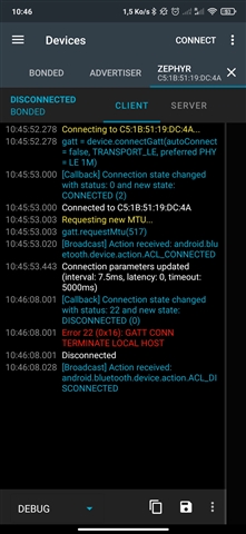

I am having an odd problem. I am using an SoC based on the nRF52832 (the ISP1507-AX). So far I had been using ncs v1.6.0-rc2 during development. Recently I have been trying to use v1.6.0. However, when the watchdog module is used, the BLE connection is impossible (using the mobile nRF Connect App, there is some delay before disconnection):
The thing is, this only happens on 1.6.0 and NOT on 1.6.0-rc2. I haven't tried other releases so far.
Thus, I constructed a sample reproducing the error. This very vaguely resemble the architecture I've been using. Am I doing something wrong ? And why would it not happen on 1.6.0-rc2 ?

You just have to comment out or not the define at line 133 to reproduce the behavior. I have tested on this SoC based on the nRF52832 because I don't have other boards on hand.
