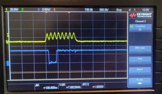

The scope image when trying to send the command 0x9f is as shown below.

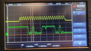

what we recieve is :
the read values while debugging.
    If blue is MOSI and yellow is SCLK then it seems like it sending the correct command 0b10011111? Could you confirm by using a logic analyzer? If it's sending the correct command, could you compare the output from the nRF and your other board and check with a scope if the sequence is the same?
    Is there a specific reason for why you're doing this in two transactions and not one?
