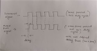

How to start pwm sequence after particular time delay of gpio event?
I am working on an application where I need to start pwm sequence after particular delay (accurate delay of multiple of 100us).
I am quite new to nordic environment.
Here is my code . Can please guide me what is wrong here??
    Could you show me the entirety of your main.c code?
    Right now I do not see where you setup your gpio for triggering the enabling of the timer, so I am not sure that the timer is ever started, for instance.
    Could you also elaborate on what behavior you are seeing, and how this differs from what you would expect? Does the device reset for example, or is it just that 'nothing' is happening, for example?

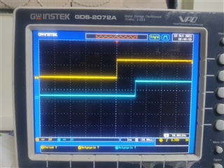

    1)the timing is not correct .Here I am attaching the snapshot of it
    From the picture you can clearly see that the delay time is more than 1ms .
    How can I make it exact??

    This does indeed not look correct - that is quite the added delay, more than 200 µs it seems.
    Could you clarify exactly what you are scoping here with the blue and yellow line? I assume it is the inputted PWM and the resulting delayed PWM output, but it would be good if you could confirm / specify this.
    To debug this we will need to find out where in the chain of events this delay is introduced.
    Could you try this again with different delays, so we may see if there is an issue with the timer configuration for instance?

  • Hello Karl,
    Yes ,you assumed right .Yellow line is inputted PWM and blue line is delayed PWM output.
    I tested with different delays that is 1ms ,2ms ,3ms etc .Every where the same added delay around 200 µs
    coming.
    Alternatively, as a debugging measure, you could change to have the TIMER CC event connected to a pin toggle TASK, so we may verify that the timer is producing the correct delay.
    I tested this and the output is attached here in below .
    Here yellow line is inputted PWM and blue line is gpio toggle output .
    Here you can clearly notice that 2ms timing is exact.

  • Hello again Ram,
    Thank you for the clarification and update.
    RAM_MS said:
    I tested with different delays that is 1ms ,2ms ,3ms etc .Every where the same added delay around 200 Âµs
    coming.
    This is great steps for the debugging - well done!
    So, it it clear that the timer toggles the GPIOTE at a precise interval, and that the delay is added elsewhere.
    Could you check whether you are receiving any EVENTS_SEQSTARTED events in your pwm event handler?
    To find out how long it takes from the PWM start task is triggered until the SEQSTARTED event is received you could use the nrf_timer_cc_read function in the timer's event handler for the CC event, and then again in the PWM handler for the SEQSTARTED event - then subtract the initial value and the added delay to find the difference.
    Could you show me your code as it is right now? I will take a look and see if I can spot what might be adding the delay.
    Did you change it so that you are providing the pwm_start_task_address returned from the nrf_drv_simple_playback call to the PPI initialization?

  • RAM_MS said:
    Here I attached the code for your reference.
    Thank you for sharing the code.
    Looking through the code I notice that you are initializing the GPIOTE as a low-accuracy input, in the line:
    nrf_drv_gpiote_in_config_t in_config = GPIOTE_CONFIG_IN_SENSE_LOTOHI(false);
    Could you try to change this to high accuracy, by changing the configuration parameter to true?
    I do not really think that this should matter, since the PORT event will be triggered just as fast as the IN_EVENT, but it would be good to have ruled out as well.
    I also recommend that you define your pins using the NRF_GPIO_PIN_MAP macro instead of just writing their pin number, but this is a very minor comment on my part and it will work just as well with the pins number directly.

  • Hello Karl,
    I do not see this change implemented in the code you just shared - it seems like this might be the code that was used to test the TIMER's accuracy.
    Sorry ,You are right I shared the code that was used to test the TIMER's accuracy.
    I see that you have created a global variable to store the pwm_task_addr returned by the nrf_drv_pwm_simple_playback function call, so I assume you will be using that variable to store it, and pass it to the PPI assign function.
    Yes ,you are right I am using that variable to store it and pass it to the PPI assign function.
    You will also need to run the GPIOTE and PWM init functions before the PPI init function, to make sure that the addresses has been updated before they are connected through the PPI.
    Thank you so much Karl ,this was the problem in my code after arranging this correcting now I am able to get exact TIMING Delay .

    As earlier I said for testing purpose I generated 1st in the same DK in PWM_PIN(11).
    But for now I commented this part by commenting pwm1_init();
    And giving INPUTTED PWM Signal from Different DK in PIN_IN (22);

    I do not immediately see the reason for why the phase shift would be happening, but I suspect that it might be because the PPI channels are left enabled throughout the run of the application, so that there might be happening a brief stopping and re-starting of the waveform generation, or similar, causing the phase shift.
    Could you try to implement the stopping / disabling of the GPIOTE pin, TIMER instance and PPI channels when the PWM is successfully started, like we talked about earlier?
    By the way, you can change your GPIOTE_CONFIG_IN_SENSE_LOTOHI(true); back to false again - since this was not the cause of the added delay earlier.
    I also notice that you are still not using the pwm start task address returned from the nrf_drv_pwm_simple_playback call, since it is overwritten by the call to nrf_pwm_task_addr_get in the ppi_init - this should not matter though, since they should point to the same address - but I point it out to avoid any confusion since you have stated earlier that it is this return address that is being used.
