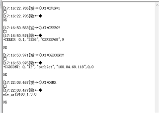

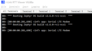

               When I connect NB net by serial_lte_modem application,no new connect log printf in JLINK.
    AT LOG,
    JLINK LOG

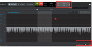

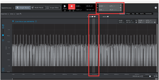

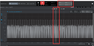

  • Now,config to NB net, enter PSM mode.
    The current is 12uA
    Amplify the signal. Between two signal bumps,the current is 2uA
    A  period ,the current is 13uA
    Is this result correct? The PSM current is 2uA?What causes the periodic increase in current? Is SYSTEM wake up?

    I've asked our expert on his opinion regarding the numbers that you provide. The response is that the spike frequency fits the refresh mode in PSM, which does look correct. However, the numbers are somewhat high. What equipment are you using to measure? Can you please check the results with multimeter connected to the current measurement header?
    What version of the nRF9160DK are you using?
