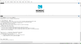

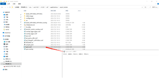

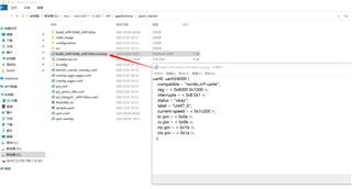

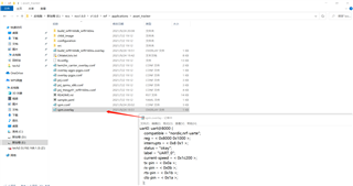

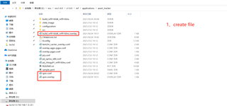

I want to modify uart0’ tx and rx in spm‘s zephry.dts,Figure below are my modification steps,But it failed.
But it failed.
Hi sport team
But it failed.
You can use the child_image folder to change the configuration of child images such as the SPM.
For more information on how to use the child_image folder, see the multi-image user guide.
Didrik
