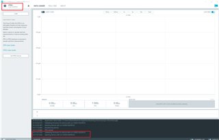

I got PPK2, connected it to Windows 10 PC and it is recognized as "nRF Connect USB CDC COM5". LEDs turn on Grenn color but immediately fade out and becomes red and stays like that. nRFConnect's Power Profiler app, allows me to select device "PPK2", but after the selection nothing changes, I don't see the menu with measurement mode selection, start the measurement, etc. The log file shows "Validating firmware...| " Opening device ..." and stops thre.

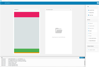

    2. Open the "Programmer" tool, select the PPK2 device and it will read the flash content
    3. Close the Programmer

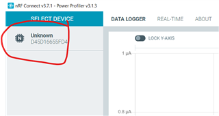

    5. You get an Unknown device, select it
    6. You will get a message "Device must be programmed", Select Yes and wait for it to be programmed

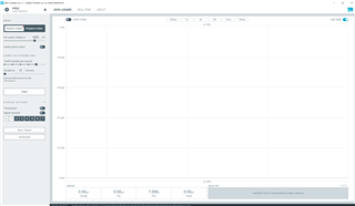

    7  Once it is programmed, it will appear as a working PPK2 and you can use it....UNTIL
    8. YOU CAN USE IT UNTIL YOU CLOSE THE POWER PROFILER APP.

    When it gets stuck, only the first two lines appear. Based on my experience, my best guess is some timing issue with your USB CDC stack, during the enumeration, but It could be that I am wrong. BTW. the same notebook (HP Workstation) works perfectly with nRF52 DK, nRF52849-Dongle, and any other device, either directly connected or via some USB hub, but again, I might be wrong, indirectly blaming the PPK2 firmware for this.
