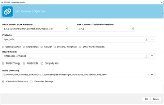

I followed the steps below and failed to compile the v1.7.0\nrf\samples\matter\light_bulb program:
1. Enter the v1.7.0\toolchain directory and double-click "SEGGER Embedded Studio.cmd" to open SEGGER.
2. Click "File"->"Open nRF Connect SDK Project"
3. Select the light_bulb project in matter in the Project column, as shown in the figure below:
4. Click "Rebuild" and the following error appears:
Rebuilding ‘zephyr/linker_zephyr_prebuilt.cmd’ from solution ‘build’ in configuration ‘Common’
1> Combining ‘zephyr/linker_zephyr_prebuilt.cmd’
1> zephyr\CMakeFiles\linker_zephyr_prebuilt.cmd-a833d9e.bat b9ac94e79f037c6a
1> Error starting process zephyr\CMakeFiles\linker_zephyr_prebuilt.cmd-a833d9e.bat
Build failed
The same operation, compiling v1.7.0\nrf\samples\matter\light_switch is successful.
How is matter\light_bulb compiled?

  • I get the same linker error as described above when executing the build in SES. Any other project works fine with the installed NCS SDK v1.7.0. By that it can not be an issue with the SDK installation.
    Are you really able to build successfully within SES or are you maybe using west command line building outside SES?
    Yes, I build and re-built using SES Nordic Edition, following the description in the original ticket.
    Are you seeing the same errors as Zero mentioned?
    Could you try to reinstall the NCS SDK v1.7.0 using the Toolchain Manager, like I asked Zero to do?
    Karl
  • Yes, I see the same error as Zero mentioned. It is actually a linker error.
    I already installed NCS SDK v1.7.0 using the Toolchain Manager.

  • Now I loaded the same project in the same NCS 1.7.0 environment into nRF Connect for VSC and here it is built without any problems. It's meanwhile already running on the devkit.
    So it is definitely an SES problem, or at least something which relates to SES. I will now no longer investigate on this as we anyway will switch over to nRF Connect for VSC.
    My final recommendation now would definitely be to switch over to nRF Connect for VSC for new projects like Matter.
