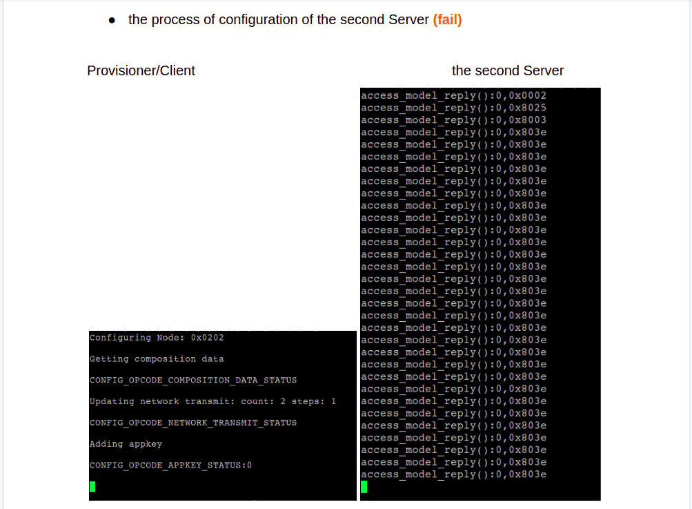

So I check configuration process, and found it often stuck in receiving opcode CONFIG_OPCODE_MODEL_APP_STATUS or CONFIG_OPCODE_APPKEY_STATUS, although Server receive opcode CONFIG_OPCODE_MODEL_APP_BIND or CONFIG_OPCODE_APPKEY_ADD and reply successfully (return NRF_SUCCESS),
but Provisioner/self provisioned Client didn't receive this reply, although Provisioner/self provisioned Client retry send APP_ADDKEY and wait for an ACK from Server for 2-3 times,
this situation keeps occur

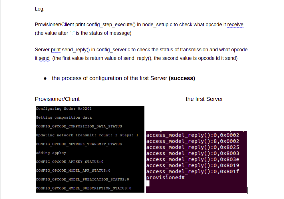

Log:
Provisioner/Client print config_step_execute() in node_setup.c to check what opcode it receive (the value after ":" is the status of message)
Server print send_reply() in config_server.c to check the status of transmission and what opcode it send  (the first value is return value of send_reply(), the second value is opcode id it send)
  • the process of configuration of the first Server (success)        Provisioner/Client                                                                   the first Server
  • the process of configuration of the second Server (fail)
                    Provisioner/Client                                                                                                     the second Server

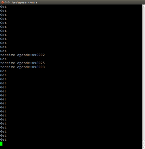

Then I check  function scanner_rx() in scanner.c of Provisioner/self provisioned Client, filter MAC address of the second Server to see if Provisioner/self provisioned Client receive messages from the second Server, I found Provisioner/self provisioned Client keeps receive messages of the second Server like below
  • Provisioner/Client:
            one "Get" means get one message from the second Server ( recognized by MAC address) ( scanner_rx() in scanner.c)
            "receive opcode: (mesh_msg_handle() in access.c)

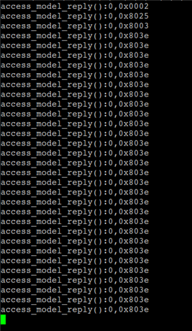

  • the second Server
             "access_model_reply()" (send_reply() in config_server.c)

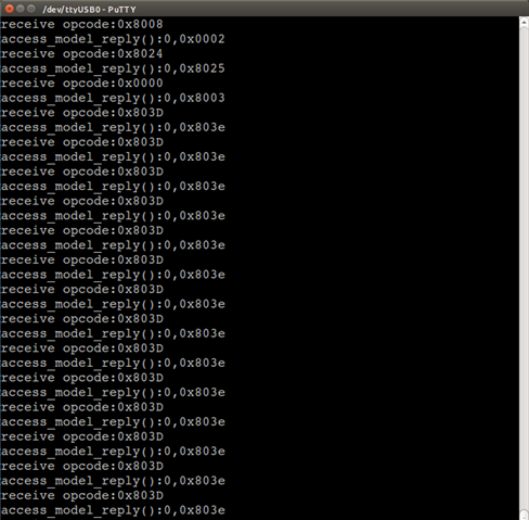

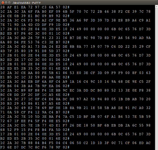

  • the first Server:have been provisioned and configured, help me to print the payload of the second Server ( recognized by MAC address), 1-31 bytes are payload, the last byte is header type, '#' is the end of line  ( scanner_rx() in scanner.c)
it seems like Provisioner/self provisioned Client can receive messages from the second Server but the ACK of Configuration, it confuses me, is there any way to analyze the payload from the second Server?  or Is there any chance that the ACK message of Configuration is filtered out by application of Provisioner/Client?
