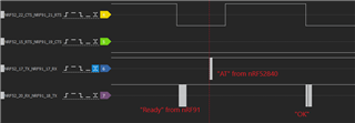

When I enable HWFC on both sides, it seems working ok. When I send 'AT' from 52840 I got 'OK' back from 9160. But when I look at the actual lines, I noticed that nRF52 RTS (nRF91 CTS) is always low. Is that normal? I do have a BLE connection while doing these tests. I expect to see it toggling sometime. I do see the other line (NRF52CTS-NRF91RTS) toggles based on when I send 'AT' from NRF52 to NRF91.

    Eventually project will go into power optimization stage where everything needs to be low power. So I'd better to make sure my HWFC works properly. I attached digital analyzer tracing. As you can see the RTS from nRF52 is not toggling.

    Why you say it's on the NRF91 side? If it's RTS for NRF52, then should it be on the NRF52 side?
    Is it possible that there's never been a conflict so there's no need to raise the line?
    My apologies for the confusion. You are right, it is the nRF52 side that doesn’t act as expected.
    This could be an explanation, yes. One way to check if the line is okay could be to configure the UART on the nRF52 side with UART_CFG_FLOW_CTRL_NONE and use uart_line_ctrl to toggle the RTS line manually.
