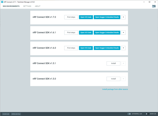

I started using nRF Connect for VSCode a couple of days ago on one computer and it has been working great. Now I had to switch to a new computer where I had also just briefly tested the extension with sdk version 1.6.1. I updated the settings for sdk and toolchain to  v1.7.0. I was able to build the project, but I wasn't able to see my device in VS Code.
I tried reinstalling the command line tools and tried adding the path to environment variables. This didn't help so I tried updating the toolchain in Toolchain Manager and open VS Code from there.
Toolchain manager checked and installed required extensions and I was also prompted to disable some conflicting extensions when VS Code was opened. Neat!
But now I am not even able to build anymore. I tried first with my application and then with one of your sample applications from v1.7.0.
