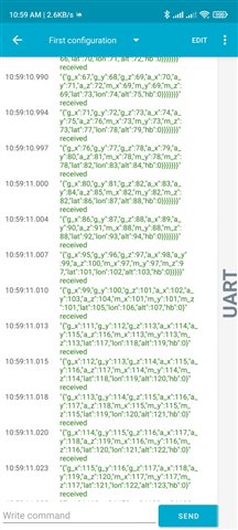

    It means my code is like incrementing every value  last some data has been missed some data in between missed as i receive 162 number after i receive 198 so many notification missed on nrf toolbox .

    and when i open both then i receive everything but throughput is just 41kBps . Previously i have told you less throughput but now my throughput is 41 kBps but i want to achieve more .
  • So these are logs from nrf toolbox , I am simply incrementing the data but many notification got missed as you can see after 67 i received 71 and after 71 i received 76 . and 1 thing i want to clear is its with same data rate means 41kBps .
