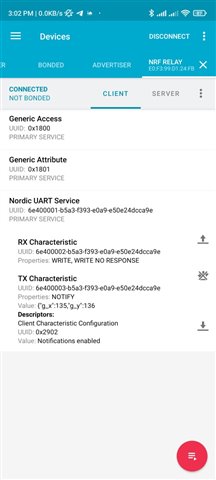

want to achieve 1-2 Mbps through BLE.
I am working on project in which i want to read data from sd card and send it to mobile through BLE , I am using ble_nus_send to send data but when i decrease the delay then its giving me error 19 and when i increase delay then it is running smoothly .
Can i achieve something between 1-2 Mbps through ble_nus_Send or have to do with some other approach .

  • ble_nus_data_send giving me error 19 .
    Have you successfully merged the NUS service into the ble_hrs_c example?

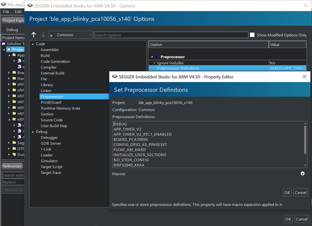

    Please make sure to have DEBUG defined in your preprocessor defines, like shown in the included image:
    This will make your logger output a detailed error message whenever a non-NRF_SUCCESS error code is passed to an APP_ERROR_CHECK.
    Please do this, and let me know what this error message reads.
