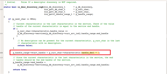

    Attached the screenshot, where the log I added in on_characteristic_discovery_rsp function of ble_db_discovery.c :
  • Is there any reason that may cause the 2nd characteristic cannot be correctly discovered by the nRF52840?
    The 1st descriptor of the 2nd characteristic has custom UUID, and I found the UUID is the same as the 1st characteristic.
    Since I'm not so familiar to BLE spec, could custom descriptor and custom characteristic has the same UUID?
    But why Android App can discovery the 2nd characteristic.
    Because the peripheral is provided by our customer, so if it's a restrictions from the spec.
    Could you help to provide where could I find the restrictions from the spec.

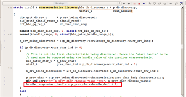

    In the 1st log (NORF52833), the fist found characteristic has Attribute handle 0x0028, Characteristic handle 0x002a.
    And ble_db_discovery.c will received characteristic with handle_value 0x2A, and handle_decl 0x28
    And the next characteristic discovery will from handle_value +1, so it start with 2B,
    and then got no attribute response.
    In Android sniffer log, after android found the 1st characteristic with Attribute handle 0x0028, Characteristic handle 0x002a. It start 2nd characteristic discovery start from 0x0029 instead of 0x2B
    So it can find the 2nd characteristic with attribute handle 0x0029, Characteristic 0x0029.
    Then I tried to change the ble_db_discovery.c, update the next discovery start to from handle_value +1 to handle_decl +1
    And then NRF52833 could found the 2nd characteristic now.
    But since I’m not so familiar with BLE spec, I’m not sure if this modify may cause any other side effect.
    Could you help double confirm this solution for me?

    I do not immediately see that it is a problem, but I also am not sure why you need to do this. I am wondering if the problem here is how you configure the discovery module rather than the discovery module itself. Can you share your code so that I see how you have done this? (please du not use images but rather share the code as text using either Insert -> Image/Video/File or by copy pasting into Insert -> Code, as that makes it easier to read and search.)
