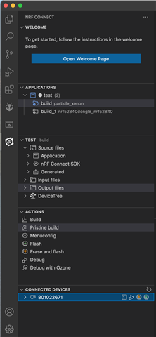

With nRF Connect for VS Code, I'm able to compile and build a simple Blinky application. Also, my connected J-Link EDU Mini and the nRF52840 board attached to the J-Link does appear under the NRF CONNECT | CONNECTED DEVICES tab. However, when I attempt to flash the program, I get the following error message.

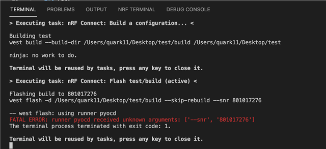

I can use exactly the same connections (i.e J-Link EDU MINI V1 + nRF52840) and flash the same program using PlatformIO from VS Code without any issues, but switching to nRF Connect within VS Code & attempting to flash gives the "FATAL ERROR: runner pyocd received unknown arguments".
I have repeated another installation of nRF Connect v1.70 on macOS 10.13.6. After verifying the nRF Connect v1.70 installation, tools, nRF Connect for VS Code and the blinky example, I get the same the "FATAL ERROR: runner pyocd received unknown arguments" (as in macOS Big Sur 10.16).

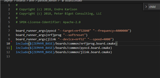

    It seems like our extension should specify what "runner"  west flash should use. It doesn't make sense to select PyOCD when it sees that a J-link is connected. As a workaround, can you try to add nrfjprog to the board configuration as I suggested in my reply here: https://devzone.nordicsemi.com/f/nordic-q-a/79771/mcuboot-configuration-for-the-custom-adafruit-feather-nrf52840/330279#330279 ? I will report the issue to our VS code team in the meantime.
    Vidar
    Edit: I see now that the xeon board already includes nrfjprog as a runner. Please try to move it to the top in order to make it the default.

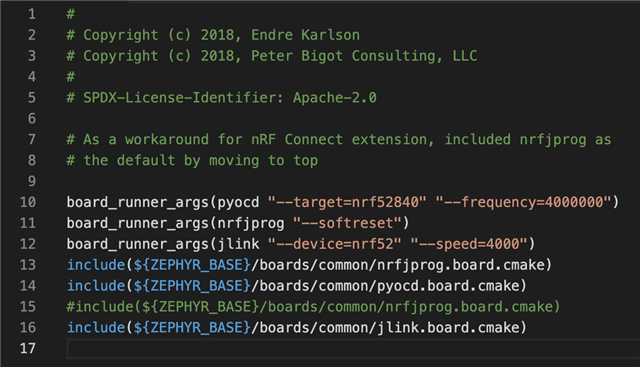

  • Hi Vidar,
    Thank you for the very quick response. It's much appreciated.
    Yes,  it doesn't make sense that the nRF Connect extension tries to select PyOCD when it sees that a J-link is already connected. We should not have to modify the board.cmake in the Zephyr directory in order for the nRF Connect to flash.
    I made the suggested workaround for both macOS 10.6 & macOS 10.13.6, updated the particle_xenon board.cmake to
    I was able to successfully flash the particle_xenon board both on macOS 10.16 and macOS 10.13.6. Thank you!

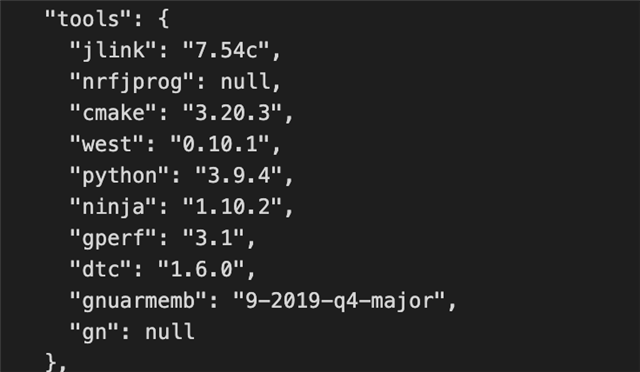

    I noticed that "nRF Connect:Generate Support Information" for the three different macOS versions have different entries that are reflected as "null" but those tools are accessible from the terminal.
    Here are the different "tools" sections.
    macOS 10.16: nrfjprog shows up as "null" but is accessible from terminal
    "tools": {

    Ignoring "gn":null, Is there any particular reason why nRF Connect doesn't pickup the version numbers of the other entries that have "null"?
    What can I modify to correct the above entries? Is it possible to do so through the nRF Connect settings in VS Code?

  • Hi Ravi,

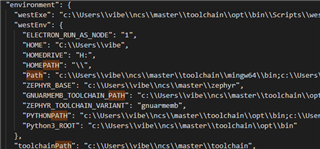

    Yes, I agree. The team also said they would try to address this issue in the next release. With regards to the nrfjprog entry being set to null, I wonder if it may be related your path variable. I don't have a mac here to test with right now, but can you please check if PATH in environment": {} include /usr/local/bin where nrfjprog usually is installed?
    Here's the from my windows system for comparison:
    Vidar

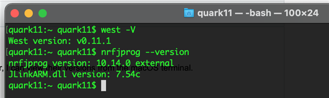

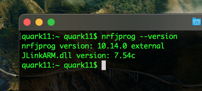

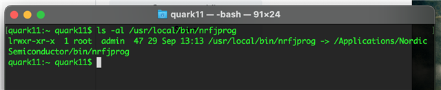

    I think I've found out what's going on with the nrfjprog entry being set to null when  "nRF Connect: Generate Support Information" is under macOS 11.6 with the latest nrfjprog. Something may have changed in the latest nrfjprog 10.14.0.
    I installed the nRF-Command-Line-Tools_10_13_0_OSX, and got the expected "tools" entries.
    When the latest nrf-command-line-tools-10.14.0-Darwin.dmg is re-installed, I get the following.
    Again, the nrfjprog entry in /usr/local/bin is a symlink to the binary in the /Applications/Nordic Semiconductor/bin/nrfjprog but note the "external" when issuing a "nrfjproj --version".
    The nrfjprog null entry in "tools" is somewhat odd but the important thing is that nrfjprog works fine. Your nRF Connect team may want to review what's going on as Support would most likely ask customers to retrieve "nRF Connect: Generate Support Information" to aid troubleshooting.
