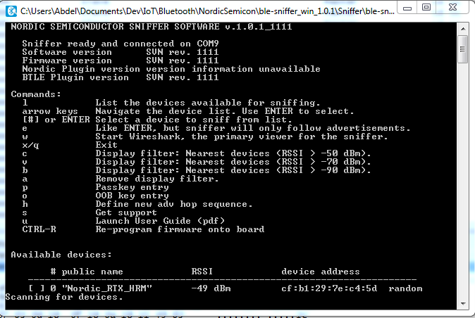

I first downloaded the ble-sniffer_win_1.0.1 from Nordinc website, besides I launch ble-sniffer_win_1.0.1_1111_Sniffer (with the dongle plugged in the computer)
When the ble-sniffer_win_1.0.1_1111_Sniffer it normally should detect all my devices(PCA10028 and S5) but it only detects the pca10028.
Note that the S5 is communicating with the pca10028 and I'm using the HRM from the nRF Toolbox. here is the screenshot of what I have when I launch the ble-sniffer_win_1.0.1_1111_Sniffer

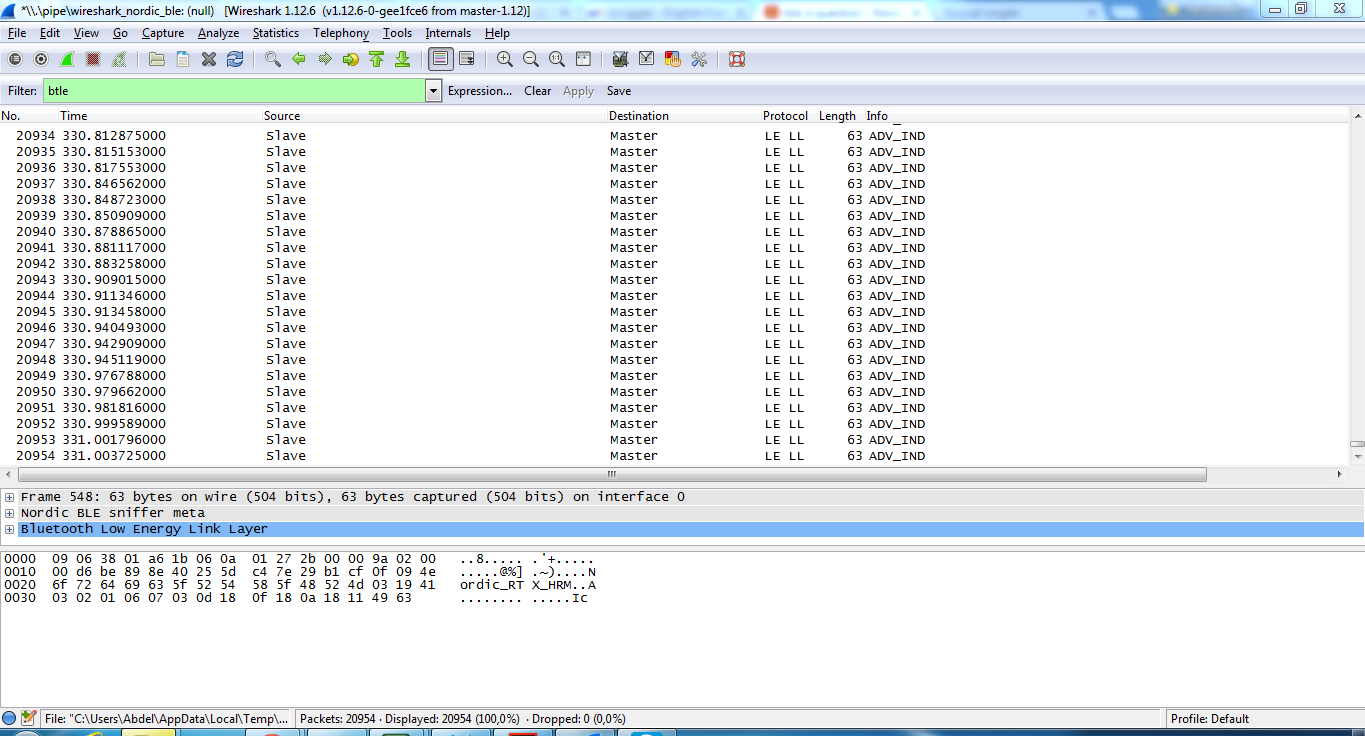

I also have a second issue when I launch wireshark. When I launch wireshark and before establishing connection between my S5 and PCA10028 I can see some data packets transiting but when connection is established everything stops and I'm unable to read packets. Could any one explain for my please what's not working well !! Thank you image description

    • When not following any connection, the scanner can only scan for broadcast packets, which mean the advertising packet. Your Galaxy S5 doesn't broadcast.
    • When you want to follow a connection, you should select the device in the list first, by using up-down arrow buttons, or press the index number show on the screen. After that the scanner will scan for only that device's advertising packets, and will follow the connection when the phone trying to connect to the device. Note that you should start follow the device before it has established a connection.

  • @Prithviraj: We have experienced this issue lately. We are suspecting some changing with Windows caused the issue. The connection is not followed. Symptom is that you can capture all advertising packet, not just the one you selected.
    The temporary work around is to unplug and plug the USB dongle , sometime it took 3-4 try to make it work again.
