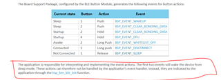

    Another question, is bsp_event_handler(BSP_EVENT_SLEEP case) involved if the system goes to OFF mode by BLE commands?
    Depends on the application. Per documentation for the BSP module:
