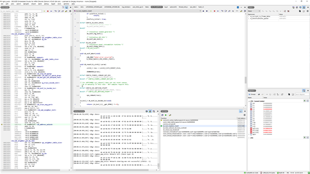

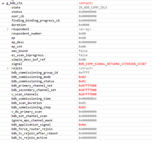

zb_nwk_neighbor_clear triggers zb_osif_abort upon joining a Zigbee network
During my evaluation of nRF52840 I discovered an issue which prevents the device from joining a Zigbee network successfully.
I'm using out of the box zigbee/light_bulb with some logging enabled. When I initiate the network joining on Samsung Smartthings coordinator, ziboss function calls  zb_osif_abort and causes the fatal halt.
I'm using nRF Connect v3.7.1.
Some additional information you might find useful:
* I have a coordinator from other vendor and if I use a dedicated channel used by that coordinator, the light bulb successfully and quickly joins it.
* You can see the call stack on the screenshot below:
* I'm attaching the log messages I see before the device halts.

  • I discovered that the system triggers a fatal halt after disconnecting from a network even if I don't use Smartthings hub but a hub which supports Zigbee 3.0
    Here are the steps to preproduce:
    1. Make a project using plain light_bulb example
    2. Select channel mask covering default channels, build and upload to the DK
    3. Connect DK to the network (in my case it's provided by a QNECT hub)
    4. Disconnect from the network
    5. Observe the halt
    Attaching the pcap, the communication is very clear, only hub and the nRF52840 DKchannel_11_halt_on_disconnect.pcapng
    If I use the channel specific to QNECT hub (channel 11) instead of the mask, the situation, for some reason, is slightly different, I still see the halt with identical stack, but the controller gets reset in a couple of seconds.
    Here is the log:
