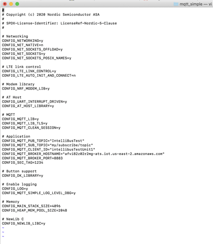

I am having an issue viewing serial communication from the nRF9160 on the LTE link monitor. I am able to view output when the code is compiled from a different computer. I am unable to view output when the code compiles from my compute (a MacOS Catalina). Are there particular settings that enable/disable serial communication on the nRF9160?
Thomas Talbot
  • Hi!
    Yes, there are settings to enable/disable serial output. Could you provide the prj.conf file of the application you are flashing and I will take a look.
    The Zephyr Logging API provides numerous backends so it's easier for me to just take a look at what configurations you have currently enabled.
    Heidi
  • Hi
    I think I need to take a look at the resulting build configurations since this seems to be a dependency issue.
    Can you find the file <build_folder>/zephyr/.config when compiling with the computer where the resulting build is able to print to serial, and the file when the resulting build is not and attach them? Please attach files, and not screenshots.
