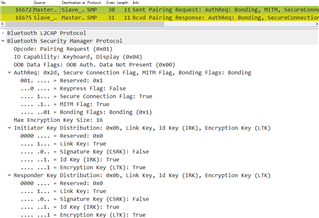

I'm using dongle nRF52840 to sniff packets between earphone & iPhone.
I am facing the same problem: "Encrypted packet decrypted incorrectly (bad MIC)"
just after LL_ENC_REQ -> LL_ENC_RSP -> LL_START_ENC_REQ
I found that in No.16672(Sent Pairing REQ), Secure Connection Flag is True,
and Encryption Key (LTK) is True.
However, in No.16672(Sent Pairing RSP), the Encryption Key(LTK) is False.
Is this possible to sniff the encryption key in secure connection? in order to decrypt the payload.....
