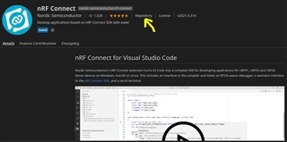

I installed the "nRF Connect" extension in vscode, and went to look into a problem I was encountering only to find the "Repository" link points to a non-existent address (https://github.com/NordicPlayground/vscode-ncs-devtools).

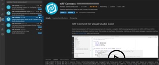

    Can you elaborate on how you installed the extension? When installing the nRF Connect for VS Code extension, you should see a Welcome Page similar to this:

  • I installed it the normal way, through the extension section.
    It's just that when you're in that extension and click the "Repository" link at the top, the address doesn't exist.nRF Connect Repository Link

    Uhh, okay that's weird. I had already uninstalled the extension and when I went back to look at the version, I now see it as "v2021.9.314". I've NO idea where that other version came from. I'm sure I had just copied/pasted it in here as well. I don't even see how I could've mistyped it if I did type it since it is so far off. In that screenshot I pasted here, it was just taken now.
    WOAH! GET THIS!!! I JUST reinstalled it, and that same version shows:
    Version Changed After Installation
    Yeah, I don't know what kind of crazy stuff is happening here...

    Heh, that marketplace page you linked to (https://marketplace.visualstudio.com/items?itemName=nordic-semiconductor.nrf-connect-extension-pack), take a look at where THAT "Repository" goes to ("404").
    Thanks for pointing that out. The issue is already reported and will be fixed I am told.
