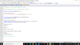

Hi Øyvind,
I think i got the issue, but i do not know why it is happening so
In my CMakeLists.txt, before adding main.cpp in light_switch sample app,
My CMakeLists.txt looks like this:
Whereas, after i try to add main.cpp in light_switch sample app (Which I am unable to add as create_nordic_project.py failed (1) error pops up), my CMakeLists.txt looks like this after the error:
Why is the CMakeLists.txt getting corrupted..?
How can i solve this..?
