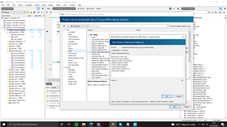

I am using th PCA10040 board, and I can build my project without problems. But when I debug it, 'stopped by vector catch' error appears. I have been reading possible solutions, and I change the placement macros, but it doesn't solve the problem.
Has anyone an idea, how to solve this problem?

  • I am runnning SDK 17.1.0, and secure bootloader (\nRF5_SDK_17.1.0_ddde560\examples\dfu\secure_bootloader\pca10040_s132_ble_debug).
    No, it hasn´t worked before. I downloaded the project,  run 'make' and then I change the placement macros to this:
    FLASH_PH_START=0x0
    FLASH_PH_SIZE=0x80000
    RAM_PH_START=0x20000000
    RAM_PH_SIZE=0x10000
    FLASH_START=0x26000
    FLASH_SIZE=0x5a000
    RAM_START=0x20002218
    RAM_SIZE=0xdde8
    There are any other changes.
