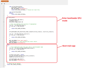

    If you haven't done it already, please try to debug the Bootloader project while sending the ENTER_DFU command to the main app and then check if the dfu_enter_check() function sets the 'dfu_enter' to true or false.
    Also, this should not be board specific, but have you verified that the GPREGRET register is set correctly in the application before it resets into the bootloader? A common mistake is to access the GPREGRET register directly while the Softdevice is enabled instead of going through the SD API sd_power_gpregret_set(). Writing directly to POWER registers will trigger the Softdevice's Memory isolation and runtime protection mechanism.
    Bootloader enters DFU mode when 'dfu_enter' flag is 'true'
    cwmoreiras said:
    Is there some minimum hardware requirements in terms of how many LEDs must be designated in the board file for the bootloader to work? My board only has 2 LEDs and implementations on the dev kits I have seen use more LEDs than that (I have done this with PCA10056 and the particle boron which has more than 4 LEDs
    There are not really any minimum requirements. But in addition to creating the custom board header file, you should comment the  bsp_board_led_off(BSP_BOARD_LED_2); and the bsp_board_led_on(BSP_BOARD_LED_2); line in main.c to make the project use 2 instead of 3 LEDs for state indication.
    The NRF_BL_DFU_ENTER_METHOD_BUTTON setting in sdk_config.h must be disabled if you don't have a dedicated button for entering DFU mode.
