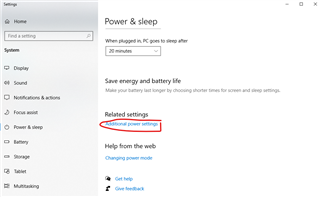

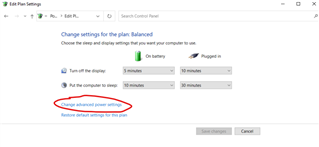

    Is there any chance your computer is configured to save power by lowering the processor usage? Check this by hitting Start and typing Power & Sleep, then click "Additional power settings". If not Select
    Try selecting "High Performance" if not already selected:

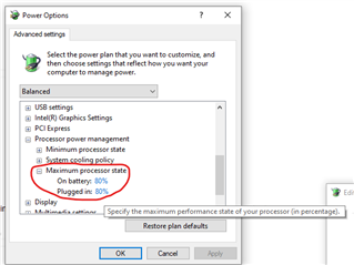

    Lower the maximum CPU speed:
    I might be wrong, however, my gut feeling says that if your fan is not coping with the heat, perhaps lowering the CPU speed might give you a better user experience. Here is how to do it in Windows:
    Why not experiment with 50% and 80%?
