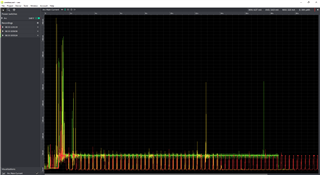

The current RRC Inactivity Timer from my provider is 10 seconds, causing my power consumption in RRC Connected mode to be unnecessarily high.
I want to use the Release Assistance Indication (RAI) feature to avoid this, but can’t get it to work.
Hardware: nRF9160 SICA B0A
Software: nRF9160: Modem Shell (https://developer.nordicsemi.com/nRF_Connect_SDK/doc/1.7.0/nrf/samples/nrf9160/modem_shell/README.html)
nRF Connect SDK: 1.7.0
Modem FW version: mfw_nrf9160_1.3.0
Here you can see that I open a socket with RAI settings, and that I transmit a ping with RAI settings, but both keep RRC mode Connected for about 10 seconds.

I think it has to do with the %REL14FEAT command not being accepted. It doesn’t give an error, but it always reads back as zero:
rtt:~$ at AT%REL14FEAT=1,1,1,1,1
OK
rtt:~$ at AT%REL14FEAT?
%REL14FEAT: 0,0,0,0,0
OK
rtt:~$ at AT%REL14FEAT=0,1,0,0,0
OK
OK
