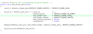

How to send additional data in eddystone protocol?
Is it possible to send additional data in eddystone protocol ?
If yes please do share a snap of code with me.
    What do you mean by additional data? There is quite a lot of flexibility in the Eddystone protocol allready, and the Eddystone example in the nRF5 SDK implements everything in the protocol.
    Note that Google discontinued Edystone in 2018, so depending on you ruse case it might not be the most suitable choice going forward.

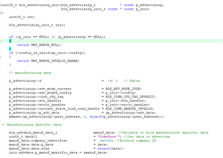

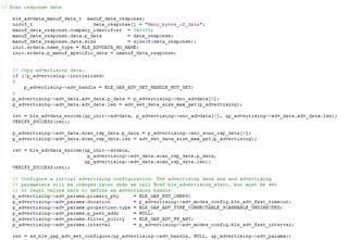

  • additional data means like manufacturing data or scan response data i.e. if i want to advertise some more data
  • It is not easy to spot the issue with snippets in screenshots. Can you post your full code as text as well as a description on how you have tested and debugged, and what you have found? Please explain if it does advertise at all, but with wrong data? And if not, what happens? Any error checks being hit? Other behavior? Please elaborate.
  • Below written is my code it's not showing any error it simply advertising in the same way as it advertise without adding any scan response and manufacturing data

    // manufacturing data
    p_advertising->d = 's' ; // Extra
    p_advertising->adv_mode_current = BLE_ADV_MODE_IDLE;
    p_advertising->adv_modes_config = p_init->config;
    p_advertising->conn_cfg_tag = BLE_CONN_CFG_TAG_DEFAULT;
    p_advertising->evt_handler = p_init->evt_handler;
    p_advertising->error_handler = p_init->error_handler;
    p_advertising->current_slave_link_conn_handle = BLE_CONN_HANDLE_INVALID;
    p_advertising->p_adv_data = &p_advertising->adv_data;
    memset(&p_advertising->peer_address, 0, sizeof(p_advertising->peer_address));
    // Manufacturing Specific data
    ble_advdata_manuf_data_t manuf_data; //Variable to hold manufacturer specific data
    uint8_t data[] = "SomeData!"; //Our data to advertise
    manuf_data.company_identifier = 0x0059; //Nordics company ID
    manuf_data.data.p_data = data;
    manuf_data.data.size = sizeof(data);
    init.advdata.p_manuf_specific_data = &manuf_data;
    // Scan response data
    ble_advdata_manuf_data_t manuf_data_response;
    uint8_t data_response[] = "Many_bytes_of_data";
    manuf_data_response.company_identifier = 0x0059;
    manuf_data_response.data.p_data = data_response;
    manuf_data_response.data.size = sizeof(data_response);
    init.srdata.name_type = BLE_ADVDATA_NO_NAME;
    init.srdata.p_manuf_specific_data = &manuf_data_response;
    // Copy advertising data.
    if (!p_advertising->initialized)
    p_advertising->adv_handle = BLE_GAP_ADV_SET_HANDLE_NOT_SET;
    p_advertising->adv_data.adv_data.p_data = p_advertising->enc_advdata[0];
    p_advertising->adv_data.adv_data.len = adv_set_data_size_max_get(p_advertising);
    ret = ble_advdata_encode(&p_init->advdata, p_advertising->enc_advdata[0], &p_advertising->adv_data.adv_data.len);
    VERIFY_SUCCESS(ret);
    p_advertising->adv_data.scan_rsp_data.p_data = p_advertising->enc_scan_rsp_data[0];
    p_advertising->adv_data.scan_rsp_data.len = adv_set_data_size_max_get(p_advertising);
    ret = ble_advdata_encode(&p_init->srdata,
    p_advertising->adv_data.scan_rsp_data.p_data,
    &p_advertising->adv_data.scan_rsp_data.len);
