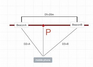

    We don't need very highly accuracy.Here is my application.
    There are two beacons with 20 meters apart. If mobile phone enter the space, we  will calculate the position P.
    ±5 meters offset is acceptable.
    I have two problems
    1.Could APP find two beacons at the time to calculate the D2 and D3?
    2.If the beacons need PA, how could I design in hardware?
  • This does not seem like a good fit for using only RSSI. Based on what you write it seems you want a higher accuracy than what is possible with this method.

    If you are going to use this in an open field, then perhaps it is OK, and that is only if you calibrate for specific phones. If not, then this is far from what you can achieve in the real world. As mentioned, you can really just distinguish between "neer" and "far away" using RSSI.
    You can scan and get RSSI data for several peripherals, yes. Perhaps not at the exact same instance, but that should not be a problem. You can use nRF Connect for mobile for testing just to get RSSI data from several advertisers.

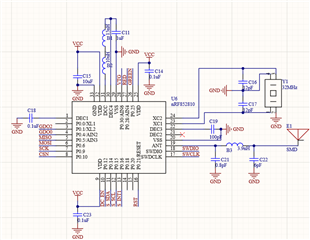

  • I have downloaded the same softdevice and app in nRF52810 and nRF52832.And I don't edit anything.
    I can find the beacon when use nRF52832, but can't find in nRF52810.Here is the hardware of nRF52810.
    I didn't use 32.768kHz crystal oscillator in 52810, but used in nRF52832.Is that question?
    Yes, that will be a problem. If the FW attempts to start the LFXO and the crystal is not there SoftDevice initialization will block forever, waiting for the clock that does not exist to start.
