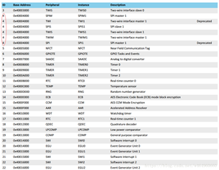

Hi:
Spi and I2C cannot be used together ? The following screenshots:
cannot use peripherals with the same ID ?
How to solve this problem ?
zxcv7063 said:cannot use peripherals with the same ID ?
This is correct, as written in the Shared Resources section of each peripheral's datasheet.
zxcv7063 said:Spi and I2C cannot be used together ?
zxcv7063 said:How to solve this problem ?
You can use these peripherals together so long as you do not use the particular instances with the same ID. In order to use SPI and TWI, you will have to use TWI0 and SPI1, or visa versa, for example. Essentially, you can not use both TWIM1 and SPIM1 concurrently.
Karl
