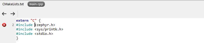

  • Hello ,
    Thanks for the suggestion, I am actually dependent on segger for my development, and the course of evaluation, I found the following issue:
    1. I started with a simple hello_world sample nCS app on segger embedded studio.
    2. Configured and enabled CONFIG_CPLUSPLUS=y
    3. Replaced main.c into main.cpp by copying contents of main.c into main.cpp
    4. Modified the CMakeLists.txt to include main.cpp as in:
    cmake_minimum_required(VERSION 3.20.0)
    project(hello_world)
    #src/main.c
    target_sources(app PRIVATE D:/CPP_Test/cpp_files/main.cpp)
    5. And ended up with this error in main.cpp:
    Kindly suggest and request your help for a way out of this on segger.
    Have attached the project For your reference

  • Hi
    I just tried to import the project I sent you in Segger, and it built without any problems.
    You shouldn't use the extern "C" keyword around the include statements, like shown in the screenshot. The extern "C" keyword should only be used in the header files themselves, and all the standard Zephyr include files already have this statement.
    If you look at my example you will see that I only use this statement in the app_bluetooth.h file.
