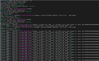

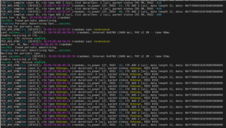

  • Hi Simonr,
    Thank you so much.
    I understood it. The reason is my smart phone can't scan periodic advertising data, it led me to think bt_le_per_adv_set_data can't work. So, I run direction_finding_connectionless_rx sample it can scan periodic advertising data.
    But it only create synchronization with a slave even if setting CONFIG_BT_PER_ADV_SYNC_MAX=3 in the direction_finding_connectionless_rx sample. So I did some changes in the sample, here is the source code,

    It can establish synchronization with 3 slaves at the same time, but can only receive IQ data from 1 tag, and sometimes the IQ-data was wrong, the following is running log
