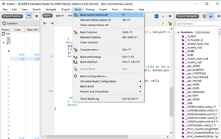

Hi Hakon
I not have the Build and Link Features → Compiler Options → Optimization level
I have only build but not have compiler option. The tools are SEGGER Embedded Studio for ARM (Nordic Edition) V5.60
Thanks
Fausto
If you go into "project -> configure nRF connect SDK project", you can see these kconfig symbols.
To make them persistent, you need to set it in your applications prj.conf file.
As mentioned, the default is to optimize for size.
