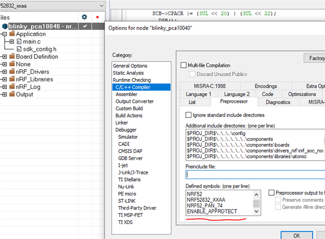

I have a further question regarding the define ENABLE_APPROTECT. It is not clear to me where and when this must be defined.
Should this be defined in the preprocessor of the project settings when I compile an image that is not intended for debugging?
Is there a sample project that shows how to use this define?
    Correct. Set it like this:
    Also, see https://infocenter.nordicsemi.com/pdf/in_142_v1.1.pdf
    There is no specific example for this. Just add the define in your project.

    Thanks for the explanation for ENABLE_APPROTECT. Sorry for this question, I haven't seen that it was already described in IN-142.
