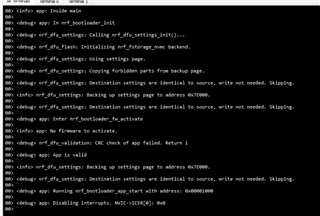

We have managed to work with s132, but when we upload to s332 it throws the following error:

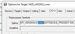

    As I was migrating the SDK examples which have included the s132, I forgot to change the preprocessor symbol from S132 to S332 as it is show in the following picture:
