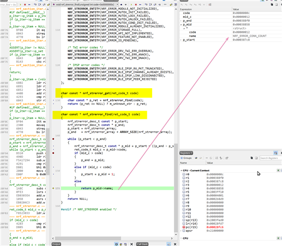

    We will need to find out exactly which function that returned the NRF_ERROR_INVALID_STATE error.
    Line 100   NRF_BREAKPOINT_COND; in app_error_weak.c
    // On assert, the system can only recover with a reset.
    Could you make sure to have DEBUG defined in your preprocessor defines for the common configuration, like shown in the included image?
    This will make the logger output a detailed error message whenever a non-NRF_SUCCESS error is passed to an APP_ERROR_CHECK. What does this error message say, and exactly which function returned the error that triggered the APP_ERROR_CHECK?
    Looking forward to resolving this issue together!
    Karl
  • this is what it says   The value is "inherits"   "BLE_STACK_SUPPORT_REQD;BOARD_PCA10056;CONFIG_GPIO_AS_PINRESET;FLOAT_ABI_HARD;INITIALIZE_USER_SECTIONS;MBEDTLS_CONFIG_FILE="nrf_crypto_mbedtls_config.h";NO_VTOR_CONFIG;NRF52840_XXAA;NRF_CRYPTO_MAX_INSTANCE_COUNT=1;NRF_SD_BLE_API_VERSION=6;S140;SOFTDEVICE_PRESENT;SWI_DISABLE0;uECC_ENABLE_VLI_API=0;uECC_OPTIMIZATION_LEVEL=3;uECC_SQUARE_FUNC=0;uECC_SUPPORT_COMPRESSED_POINT=0;uECC_VLI_NATIVE_LITTLE_ENDIAN=1;" from project in Common configuration
    "NDEBUG" from solution in Release configuration

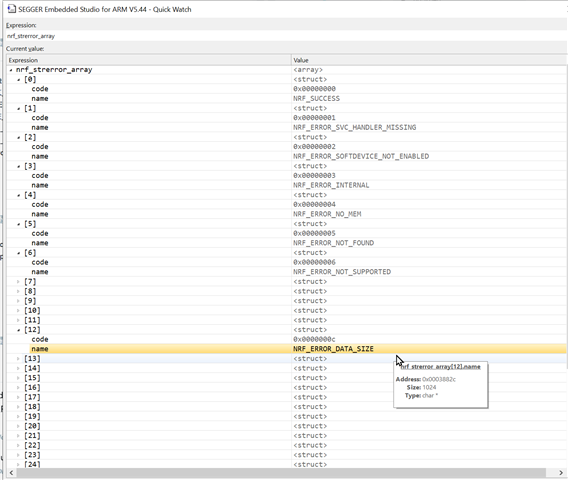

  • added DEBUG to pre-processor definitions. Still save issue. setting a breakpoint at __WEAK void app_error_fault_handler(uint32_t id, uint32_t pc, uint32_t info)
  • Error code is 12  at p_info->error_code
