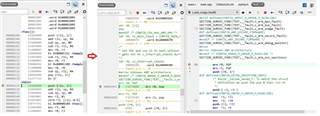

fault with calling int main( )
I modified a sample app "blinky" on segger, to include main.cpp instead of main.c
Then when I built, I got a compile time error stating in main.cpp "void main(void)" should be changed to "int main( )"
I changed and it compiled successfully.
Now when I am running it on the board, the execution is not entering "int main( )" rather the execution is straight away entering fault_s.S, as in the screenshot:
Kindly help me in understanding why this is happening so and how I can get the execution to return to "int main( )" ..?
PS. I am using blinky sample app on segger, only changes I made is
- Excluded main.c from the build
- Added main.cpp (Attaching for your reference)
- Added main.cpp in CMakeLists.txt (Attaching for your reference)
It is building successfully.

    Have you set CONFIG_CPLUSPLUS=y in your prj.conf? I recommend you take a look at the C++ Synchronization sample (which is the only C++ sample for now).
  • Hello ,
    Yes i have set the CPLUS_PLUS feature, I have also set below:
    CONFIG_CPLUSPLUS=y
    CONFIG_HEAP_MEM_POOL_SIZE=16384
    CONFIG_NEWLIB_LIBC=y
    CONFIG_LIB_CPLUSPLUS=y
    But, my problem is that execution is not entering "int main( )" in main.cpp
  • I see. I am not able to explain that, as it looks like the basic is in place. However, I do not know the details of your configuration (NCS version, toolchain version, etc). Can you test the sample I referred to from nRF Connect SDK 1.7.0 and using the toolchain manager so that you know the toolchain is good? That should work and does on my side.
    Update: I just noticed that you add both main.c and main.cpp in your CMakeLIsts.txt:
    target_sources(app PRIVATE D:/CPP_Test/cpp_files/main.cpp src/main.c)
    you should have got a linker error if main is defined in both so it is a bit odd, but a smoking gun.
    you should have got a linker error if main is defined in both so it is a bit odd, but a smoking gun. (also, you probably use relative paths to make your project portable, but that is a different topic).

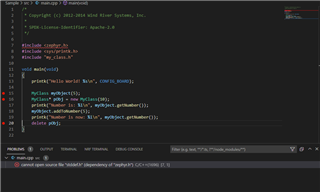

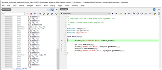

  • Hello Einar,
    I am trying to work it out,
    By starting with a simplest hello_world sample nCS app,
    I copied contents of main.c into main.cpp, then made changes in CMakeLists.txt and built, I am getting this error:
    Here is  my CMakeLists.txt:
    cmake_minimum_required(VERSION 3.20.0)
    project(hello_world)
    #src/main.c
    target_sources(app PRIVATE D:/CPP_Test/cpp_files/main.cpp)
    Further, i read that build.emProject modification is necessary when we define a new file, so I copied the fields under main.c as is into main.cpp with additional definition of "cpp_only_additional_options".
