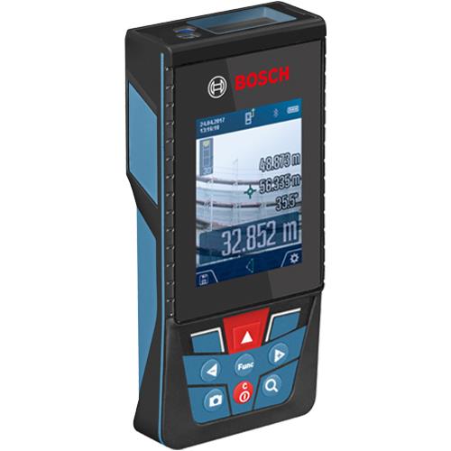

Hi.
I`m trying to figure out a way I can control a Bosch GLM120C laser measure device using a micro controller.
I`m a stage where I can activate  the laser(1st command) and take a measurement(2nd command) using NRF connect app on my phone.
Service UUID: 2A6C0D0-0451-4000-B000-FB3210111989
Command I`m writing "c05601001e"  first time it activates the laser and 2nd time it takes a measurement.
While the app from Bosch does get the distance value. I can`t seem to figure out what packet  the data is being sent back in, I`m using Wireshark and BLE sniffer(52 dongle).
https://www.dropbox.com/s/z97dv8qdbm8emja/514mm%282%29.pcapng?dl=0
Any input would be much appreciated.
Thanks Guys.
